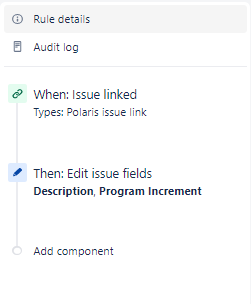

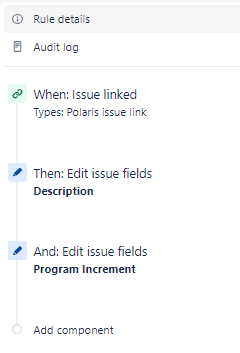

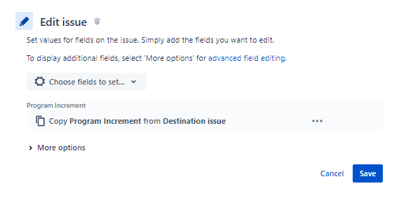

@Omer Meshar   that worked!!!  I changed the name on the JPD board and it worked.  Now to come up with a clever naming convention as the fields are the same on both sides.  WOO HOO!!!  One step closer to being able to deployment.  Here is the automation rule. Capture.PNGCapture2.PNG
