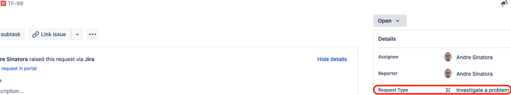

  1. Pick one ticket on your cloud site from the Issue Type that contains the Request Type you need to run the import

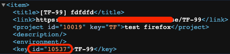

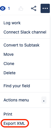

  2. Export this ticket to XML (“…“ > Export XML) to get its ID

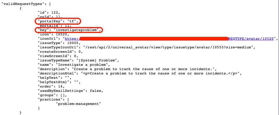

  3. Now that you have the ID, access the following endpoint on your web browser (change the {your-instance} and {ticket-ID}):
    https://{your-instance}.atlassian.net/rest/servicedesk/1/servicedesk/request/{ticket-ID}/request-types
  4. And you’ll see a page like below, related to the Request type “Investigate a problem“ and also all other Request Types related to the ticket’s Issue Type:

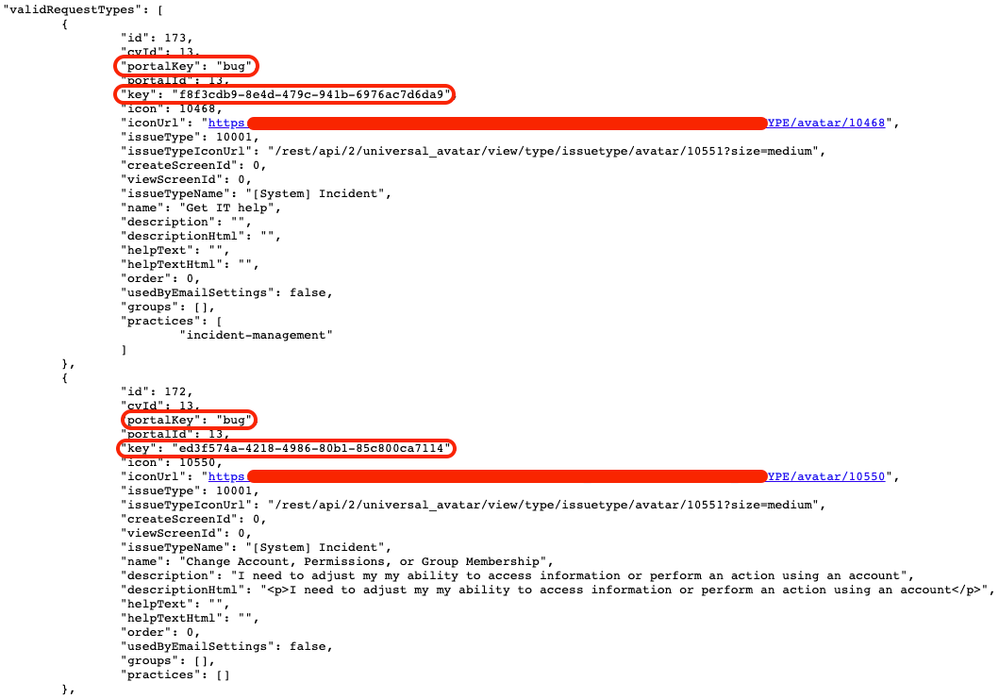

  5. The information on the key field can also have a different format, like on the image below, and you can use it the same way:
    For these cases, you need to check the relevant Request Type basing on the field “name“.
  6. And the information you need is: portalKey and key. The format needed for the CSV import is:
    portalkey/key => tf/investigateproblem
                              => bug/f8f3cdb9-8e4d-479c-941b-6976ac7d6da9
  7. And you need to use this value on the request type field when running the CSV import. Remember to also map the Issue Type field to have a correct import
