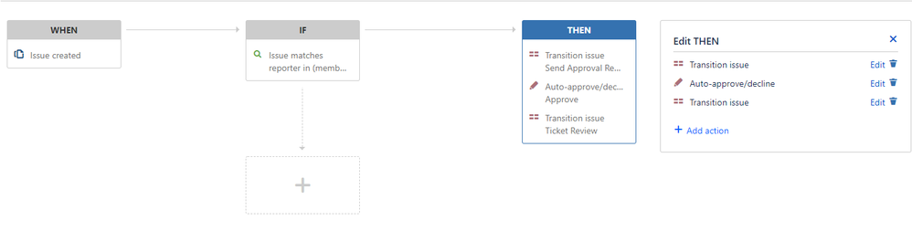

You may need to setup an automation in Project Automation that will transition the issue when transitioned. I had this issue initially as well.
In this one there is an extra transition because if the Reporter is in a supervisor group then it will automatically go through the approval.
I don't think that's the solution.
This isn't happening when the issue is created. The issue has been transitioned from "Open" to "Waiting for Approval."
I have an automation rule to look for approval via email, and it works. The item is marked as approved and the transition to the next state occurs.
But when the issue is approved in the portal, while it also shows as 'approved', it does NOT transition to the appropriate state.
Even more bizarre, if I 'decline' via the portal, it DOES transition to the appropriate state.
So, for some reason, 'decline' triggers a state transition, but 'approve' does not...
