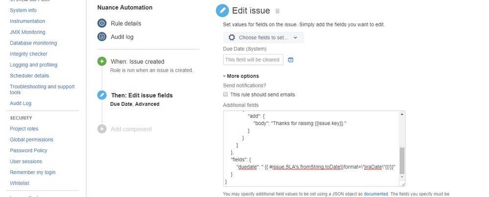

used this on already but din't work out
Error editing issuesSCLORD-1377 (Error parsing date string: format="jiraDate" (duedate))

Hi Andreas,
i did use Audit log just to get value of issue.SLA's but it shows a blank field no value is logging. please let me know what is missing here.

Hi Gonchik,
While updating "Due Date" with the value of SLA's in jira Automation i am getting below error. can you please help me to solve this.
here is the json string.
"update": {
"labels": [
"add": "triaged"
"remove": "blocker"
"comment": [
"add": {
"body": "Thanks for raising {{issue.key}}."
"fields": {
"duedate": "{{#issue.SLA's.fromString.toDate}}longDate{{/}}"
i im trying to achieve due date out of SLA. but getting below error
Error editing issuesSCLORD-1353 (Error parsing date string: . (duedate))
pleaes help me to resolve this.
