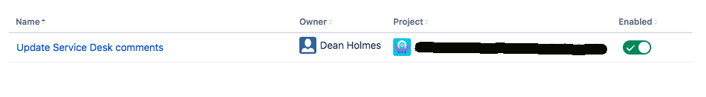

I have followed some online documentation and set up a built in automation that supposed updates comments made in Jira Software by engineers back to the service desk comment for the agents.
It’s enabled, I set up all {{ }} tags I needed but nothing happens
There is a note about permissions but I don’t see automation permissions.
I just want to update service desk ticket with comment from engineers in Jira sofware. I would have thought that would be built in for links issues.

The screenshots are below, there is nothing in the Audit Logs other showing when I created and modified it.
Screen Shot 2018-12-18 at 9.53.24 AM.pngScreen Shot 2018-12-18 at 9.53.16 AM.pngScreen Shot 2018-12-18 at 9.53.42 AM.png

Hi Dean,
Thank you for the details.
On the screenshot, it shows that the automation will only run when an issue is linked, but the right option is "Issue commented" and then add a Branch and after that "Then".
Here is an example:
Please, give it a try and let us know how it goes.
