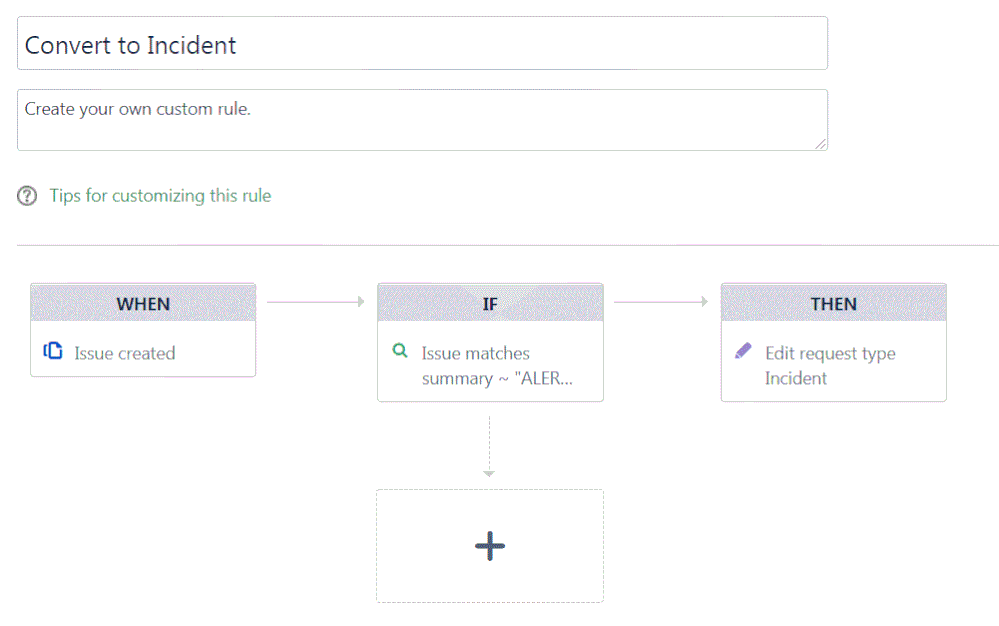

Dear @Paul Stewart ,
you can do what you want by creating your own custom automation rule:
Note: you can change the request type only, if the issue type of the new request type is the same.

Thank you - I started there however you cannot change the issue type using JIRA automation ... only the request type. I need to change the issue type in this case. Thank you.
the problem is that Request Type : Issue Type is a "many to one" relation. Means, you cannot just change the Issue Type without changing the Request Type.
What you could do, is fire a Webhook, that is calling a script, that moves this issue to another one by calling a REST method.
If this doesn't work you could transition this issue. In the workflow you could call a groovy script moving your issue (with plugin).
