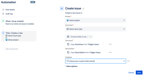

Hello @Jørgen Gomo
Thank you for reaching out.
Per your description, I understand you want to configure an automation rule to create a new issue when an issue is created, copying the values from the original issue and adding the user selected in the user picker custom field of the original issue as the reporter on the new issue created. Is that correct?
You can achieve it by following these steps:
{{issue.My custom field name}}
to copy the custom field to the assignee of the new issue created. You can follow the screenshot below as a template:You can check the documentation below for more details about smart values:
Let us know if you have any questions.

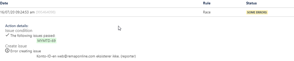

Thank you so much for the reply! Looks like the automation will work, but i get another error now.
It says that the user does not exist.
Is there any other automation to create new user based on the new issue?
Hello @Jørgen Gomo
Thank you for the details.
After reading your request a second time, I see that you want to change the reporter of the issue, not the assignee. Sorry for the confusion.
That being said, please confirm if the user added to the issue custom field is a customer in your site and edit your Automation rule to add him as the reporter field, not as the Assignee.
