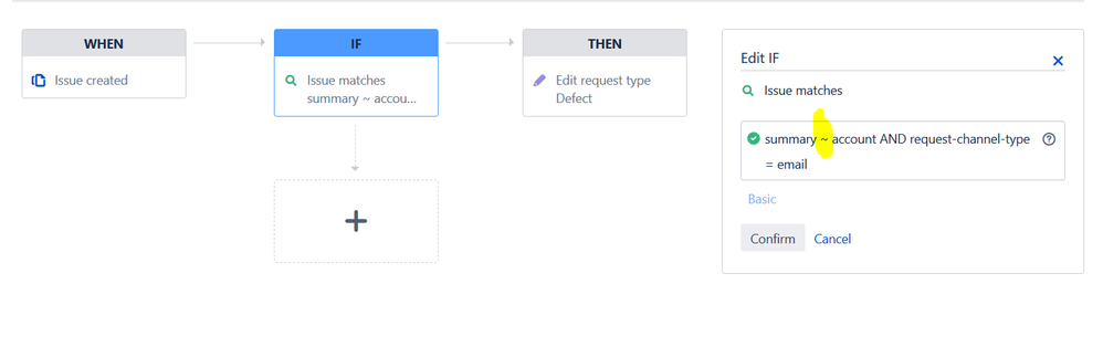

I have added a rule as attached in the Screenshot.
When i adds an issues with summary "account", my request type was not updated.
Please let me know if my rule was wrong..

Tessa Tuteleers
October 4, 2019
There is your problem then, a request type is a "child" of an issue type, you can't change the request type to one that is "under" a different issue type.
TO change request types in Jira, natively you would have to "move" the issue to the same project with a different request type, you can't do this with a "normal" edit.
As such, you can't change issue types with "normal" JIRA service desk automations
->  You could use "Automation for JIRA" - an add-on with a lot more automation power - to change issuetype and request type
-> You could set up more extensive mailhandlers with something like "Jira email this issue" to get JIRA to create the issue the right way in the first place.

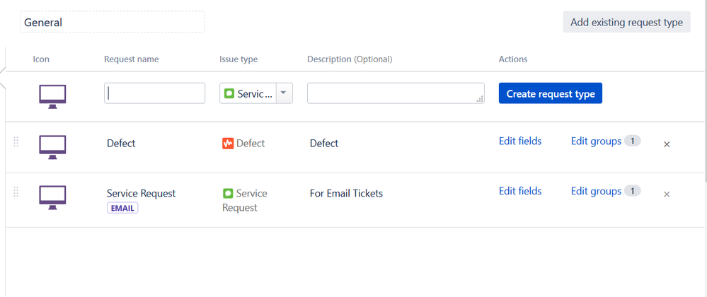

Madhu Reddy
October 4, 2019
Thanks for the response @Tessa Tuteleers
I am using JSD Email Requests..
No both the request types and issue types are different in my setup as attached in the screenshot.
Tessa Tuteleers
October 4, 2019
Hi Madhu,
I just tested this on our environment and it seems to work.
Are you sure that your request-type-channel is email? If you use your native JIRA mailhandlers or email this issue mailhandler it would be "jira" instead of email.
Next, are you sure that the "defect" request type is of the same issue type in which the issue is originally created?
You can always look in the log of the automation rule to check what happened.
