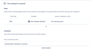

To set this up I would recommend setting up an SLA metric for entering a status such as "waiting for customer", Basically whatever status the workflow is using for the transition that occurs where you will be waiting for a reply from the customer.  Set the metric to 120h to equate to the desired 5 days after entering that status for the initial breach event, then add the "Comment By Customer" and "entered status: X" for the final closeout condition when the issue times out and transitions to your "done" or "resolved" or "timed out" status.
