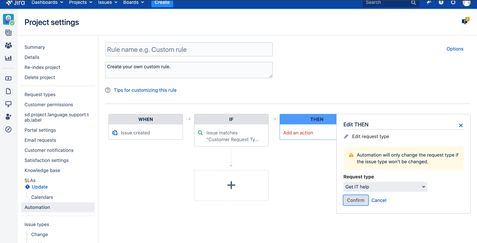

In this case, the limitation here is not in regards to the workflows in place, but rather the automation here is limited in that it can only change the Customer Request Type IF the two request types share the same issue type.  This limitation is noted when you setup this automation rule (see the yellow box in this screenshot).
If the customer requests have different issue types, automation in Jira Service Desk is not currently able to change the issue type, hence it then cannot set the request type (since requests are a layer built upon specific issue types).  The main reason for this is that Jira does not currently have a REST API to move issues.  That is essentially what has to happen in order to change the issue type here.
