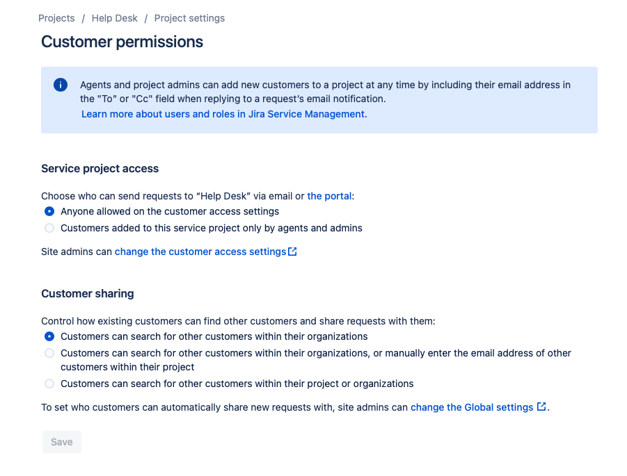

the global permission was set correctly. I found the source of the issue to be the customer permission. I did not allow customers to share with others therefore they could find them in CC.
I updated the Customer Permission like this:
Who can raise requests?
Customers who have an account on this JIRA site
Who can customers share requests with?
Any customer or organization, by searching in this project

@Ronen Erlich can you post some screenshots?
I have the same problem but even this doesn't work.. I prepared user list which should be use as a list of managers who can approve absence...every employee can pick their manager but the problem is that no one but me (administrator) can see the list.
