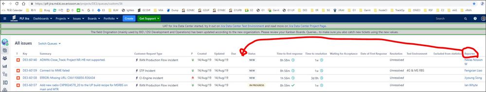

Can we edit columns from Issue list?
Ted seungsoo Moon August 13, 2019
I would like to edit the columns from all issue lists such as adding, removing and changing of sequence of existing column.
For example.
- Adding "Assignee" column
- Removing "Waiting for acceptance" column.
- Changing column "reporter" in front of "Status" column.
https://plf-jira.rnd.ki.sw.ericsson.se/projects/DE3/queues/custom/36

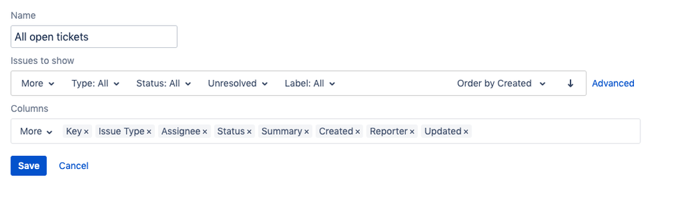

in Jira SD you can do it, but, how I can see you have not permission to do this
In my Jira SD I see this button (see on the screenshots), and can switch columns, add or delete columnsScreen Shot 2019-08-14 at 10.16.01 AM.pngScreen Shot 2019-08-14 at 10.16.58 AM.png

Hi @Ted seungsoo Moon
Yes you can edit the queue, on the right of your screen you have the edit queue button. From there you will be able to drag your columns and add or removing them.
https://confluence.atlassian.com/servicedeskserver/setting-up-queues-for-your-team-939926328.html
I think you need to be an admin of the project to do it.
Hope this helps
