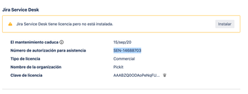

We have a problem to install on app Jira Server Desk:
we had the application installed but it was uninstalled and we cannot install it, when I press install it throws the following error:
