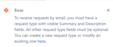

I have a request type called 'Service Request' with the following fields.
You can see it has both Summary and Description.
However, when I go to Project Settings > Email Requests > Turn on Email Support, I get this error.
How can I enable the email requests feature so that service request tickets can be sent via email?

Hello @Ian Walker
The problem is Description field, the Summary is a system field and cant be hidden
To solve this problem
Scroll to the middle and check your Filed configuration name, copy the field configuration name not the scheme name, filed configuration name is under the scheme, it will state something like Jira Service Desk Field Configuration for Project TES

Hi @Olga Videc .
Thanks for replying. I have a field configuration set up and I checked it and Description (Wiki Style Renderer) is not hidden, but it is not required either?

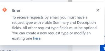

Hi @Ian Walker and @Olga Videc I am encountering your initial issue. I've tried all steps covered in this thread but I still get the error below after creating three different test Request Types with only the 'Summary' and 'Description' fields.
Do you have any other guidance for solving this issue please?
. D
