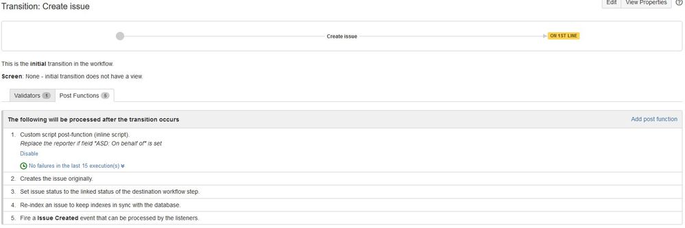

As you can see below the script itself executes after each issue. I also switched the position of the script right after "Creates the issue originally". The other steps are default steps during the service desk creation.
I only changed line 4, because the script should affect each issue and not just one specific. I will do some other tests and will inform you about my outcome.

As i can see on screenshot, postfunction placed before issue creates and obviously that will not work, cause you tryin to set reporter to issue that doesnt exist. Place your postfunction after "Creates the issue originally"
MutableIssue issue = issue
you can remove this line, postfunction scope itself already contains issue variable.
after this changes your postfunction will be work on all issues.
