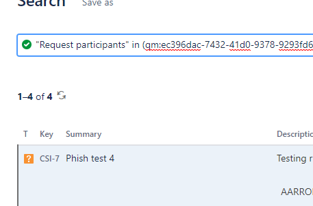

I'm soooo close ! However, I can't get the automation to 'match' the 'Request Participant' email address I'm specifying. It auto-populates the big 'qm' value, but won't accept the literal string. Am I missing something ?
@Andrew Hatch Were you able to find a fix for your issue? I'm coming across the same exact scenario!
I did ! The issue I had is that the the QM/hash value only appears with emails that have been seen within the system. So it was dumb, but just send an 'invite user' to that generic email forwarding account and I could select it.
It's crazy annoying that I can't clearly see or label that ridiculous hash, but I can usually figure it out contextually in some of the other conditions I have set up.

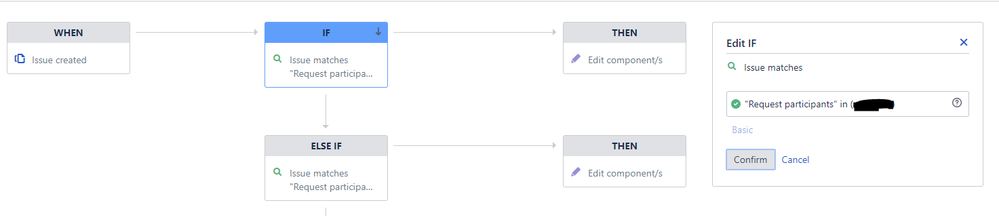

So i have my automation set up as you described however the Issue Match on Request Participants fails. If I input the same exact JQL into search, results are returned as expected for the request participant. What am I missing?
I have exactly the same issue in Jira Servicedesk Cloud.
Is this a bug ?
Same. I'm on cloud and cannot get this to work for more. The participating requestor is set correctly, and the rule is set up correctly, but the rule will not fire.

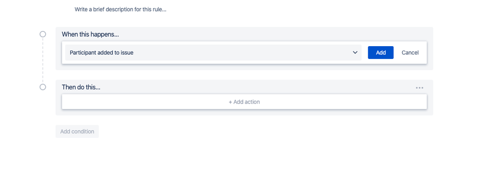

@Joel Bradley For the automation rule you have to use the trigger participants added to the issue and not "create issue"
That doesn't look like an option in Service Desk Cloud. I was able to get it to work by having the trigger as Create Issue, and then using JQL to match the participant's field.
For some reason using the GUI to match participants wouldn't work.

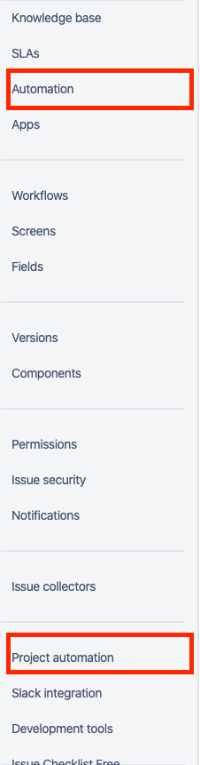

This is from Jira Servicdesk Cloud automation
Hi Joe - you are using Project automation and not Servicedesk automation - that's why :-)
Thanks! This is so confusing! AFAI can tell, they do the same thing but Automation is more advanced?
