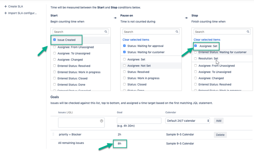

  I think the easiest way to do this would be to create an SLA and then just use that to report on the duration.
Zoryana Bohutska _SaaSJet_
January 14, 2021
Yes, SLA settings can help you. It lets you set condition and time goals. So for every ticket, you can view how long time it will take until the issue will be assigned.
