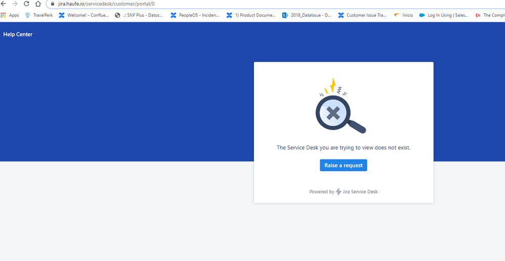

I'm trying to access the Customer Portal through the Raise a request icon in Jira SD and I get the following error on the Customer portal
I have the administrator role in Jira SD.

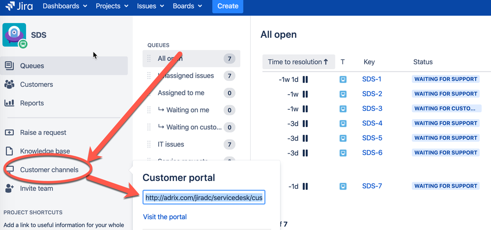

Can you confirm that the base URL is configured correctly? We have seen issues like this in the past if the base URL is not correct.
You can confirm the portal URL by going into the project settings > customer channel :
I was able to reproduce the problem if the portal URL does not exist.
For example, if my portal URL is http://hello.com/jira/servicedesk/customer/portal/1
and if I changed it to http://hello.com/jira/servicedesk/customer/portal/0
it will show the same screen as you are seeing because it does not exist.

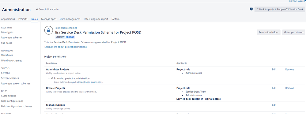

And what is the create permission. As that is what would stop you.
Susan
Hi Susan,
thanks for the reply
Yes, I am also a customer/user of the service desk.
Do you want to paste your permission scheme in here?
Did you check the permissions to make sure you are a customer/user of the service desk. Being an admin doesn't automatically grant that.
