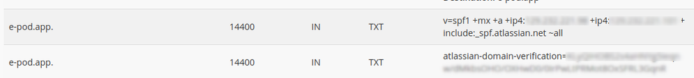

I have added the following DNS entries in my domain for DKIM and SPF by following the configuration instructions in the link below:
https://support.atlassian.com/jira-cloud-administration/docs/configure-jira-cloud-to-send-emails-on-behalf-of-your-domain/
SPF:
DKIM:

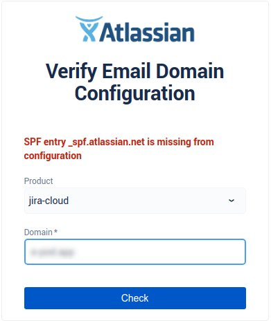

But using the verification tool https://domain-check.atlassian.com/ I still get the following error:

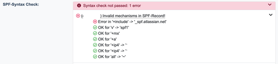

Checking the details of your domain on our tools and also external tools, it seems that what is causing the issue is the "+" sign before include:_spf.atlassian.net.
https://www.spf-record.com/
Please, edit the SPF records and remove the + sign.
