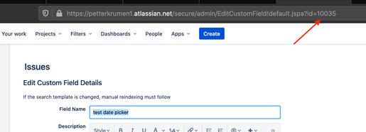

In order to confirm you are pulling the correct date field and not another custom or system hidden field with the same name, I suggest you to use the custom field ID instead of the name to reference it in the smart value of the automation. These would be the steps:
{{issue.customfield_xxxxx}}

Thanks this worked, seems that two custom fields have similar names and cause issued once I used the unique ID as recommended this alleviated the issue.

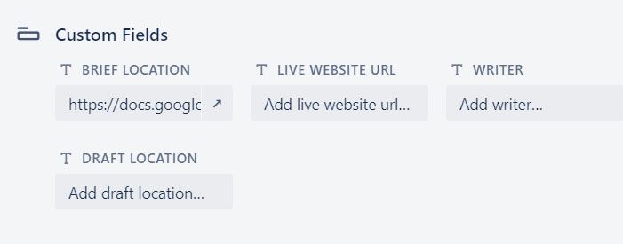

Hi Petter
I'm trying to take the link to a document from the custom field
and then create a rule based on the person we want the email sent to and create the message to include the document link.
