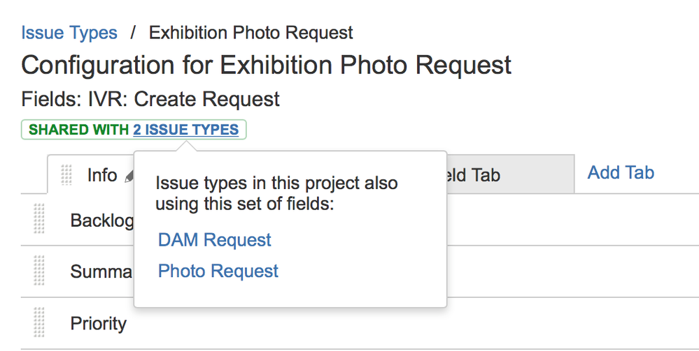

I'm not sure how to do it. When I edit one set of fields within an issue in the project it changes within the other issue types. See screenshot.
I want some fields to be different within the issue types within the project, so, not shared. That's where I'm getting confused. Screen Shot 2017-10-03 at 5.30.10 PM.png

That;s not field configuration, that's screens.
What you should do for screens, is create two.  One for DAM, one for Photo.
Then create two "screen schemes".  One should use the DAM screen, and the other the Photo screen
Third, create a single "issue type screen scheme".  In there, you can say "For DAM, use the DAM screen scheme, and for Photo, use the Photo screen scheme"
David Garfinkel October 6, 2017
I believe I have it. There's just something about the way screens and schemes exist globally and within projects...something about the logic that I always (and I think still) find confusing.
Thank you for your help!
