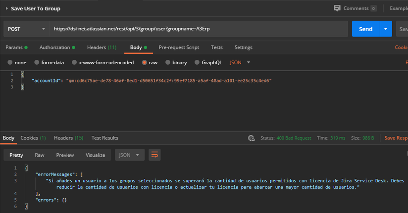

Thank you for your reply. The problem we are having now is adding a user to a Jira group after adding it as an agent.
When we use the call POST /rest/api/3/project/{projectIdOrKey}/role/{id} to add the user to the Service Desk Team, we need to add the user to a group that helps us retrieving a list of users that we control. We use the call POST /rest/api/3/group/user?groupname=X to do this funcitonality, but we receive the response attached before:
"errorMessages": ["Si añades un usuario a los grupos seleccionados se superará la cantidad de usuarios permitidos con licencia de Jira Service Desk. Debes reducir la cantidad de usuarios con licencia o actualizar tu licencia para abarcar una mayor cantidad de usuarios."],
"errors": {}
We do not know why are we receiving this response because we are not adding any other users, we are only adding a user to a group. How can we add the user to the group without receiving this response?

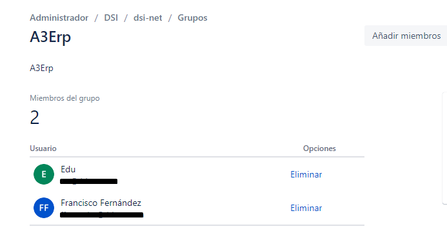

We have got 2 members in a group named A3Erp:
If we try to add the user, it works perfectly:
However, if we remove the user Carlos and try to add it again through the API, we receive the error that we commented before:

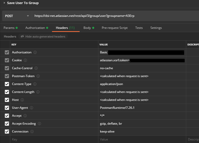

The headers added are:
Hope this information helps.
