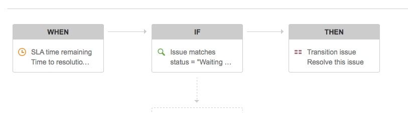

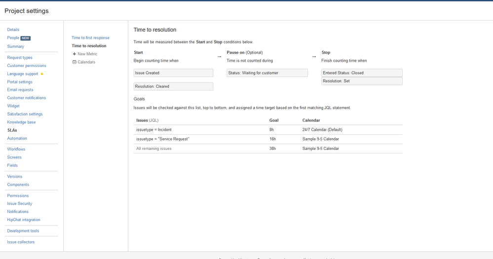

here is a quick pic of the automation i just did below. note that it us using Time to resoulution SLA here because that is all I have in place. but you "should" be able to create the new one and selcect here. the IF statement is for issue matches status = Waiting for customer, and the THEN is to transition to resolved.

Alden Mann September 18, 2017
I dont see the option to close when waiting for the customer anywhere.

Jack Brickey
September 18, 2017
Alden,

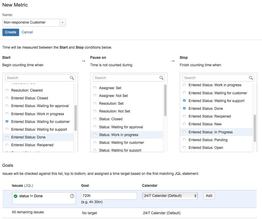

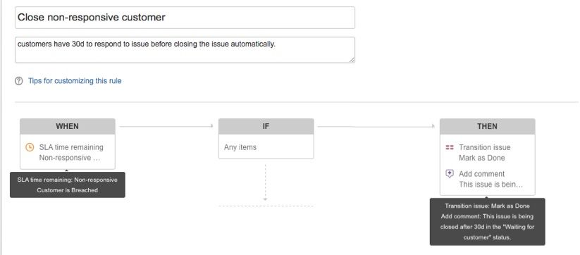

as I mentioned before you have to create the new SLA and new automation. Below is what I defined and if you follow it you should be fine. NOTE: you will want to tweak things a bit for your specific use case, e.g. statuses, timeout duration, etc.
1. Define the new SLA - Project > Project Settings > SLA click on the "Switch SLA" link at top and select New Metric. Here are the details for SLA...
2.  Define the new Automation - Project > Project Settings > Automation. Here are the details...

Jack Brickey
September 18, 2017
BTW....don't edit the Time to Resolution SLA create a new one as I mentioned.
Like Sanjog Sigdel likes this
THANK YOU. set it up just like that. I appreciate the walk through.

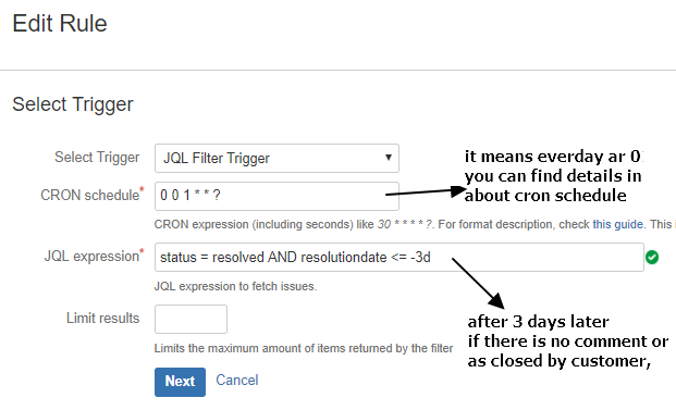

Hi Alden;
You can create a rule on Automation tab in Administration and click "add rule";
Give rule name;
Cron schedule detail link as below
https://confluence.atlassian.com/servicedeskcloud/constructing-cron-expressions-for-a-filter-subscription-780868201.html
but your request like below.
0 15 8 15 * ?   (8:15 am on the 15th day of every month.)

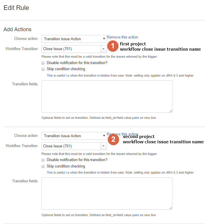

in JQL , you can add status as "waiting for customer" or whatever you want.(our rule like this : status = resolved AND resolutiondate <= -3d means when status reslved and customer does not change staus as closed in 3 days , automacly chage status as Closed  )
Important thing in next step; you have to choose correct close transition name.
Important thing in next step; you have to choose correct "close transition" name. so you can check close transion name in project workflow. Becuse every transition action is displayed in this part.
I hope it will be helpful
Best regards

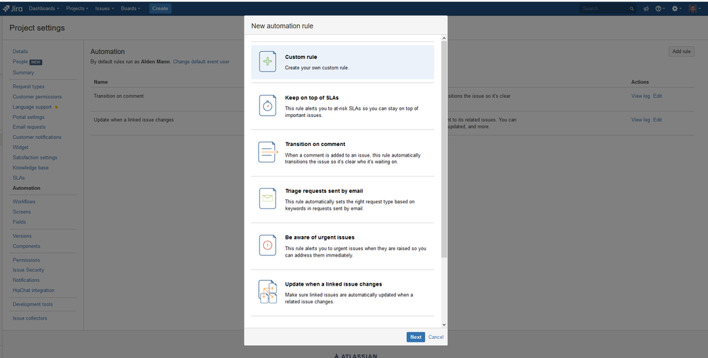

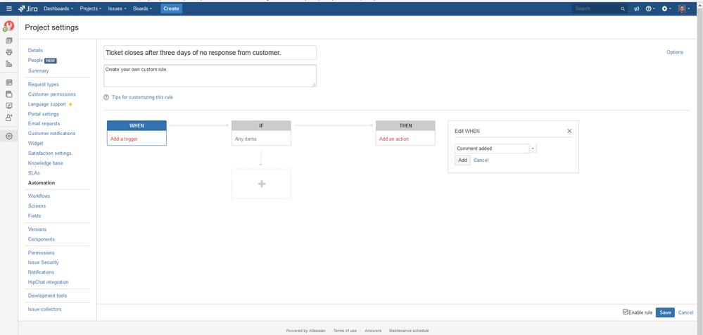

Alden Mann September 14, 2017
My friend, jira 1.5.PNGI want to thank you for taking the time to answer and to answer in such detail. However I am not getting the same set up options and it is causing some confusion. I am attaching pics.. Thank you in advancejira 0.PNGjira prob 1.PNGjira 1.5.PNG

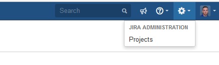

it is not in project setting; it is in Jira adminisitration-->Add-Ons-->Automation
Alden Mann September 15, 2017
Hello Volkan,
My only option when clicking the setting is projects.
Jack Brickey
September 15, 2017
Alden, you appear to be on Cloud whereas Volkan is on Server. So there are differences there. There should be a way to do this w/in cloud automation however. I will have a look and get back to you.
