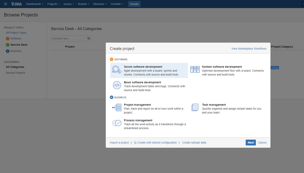

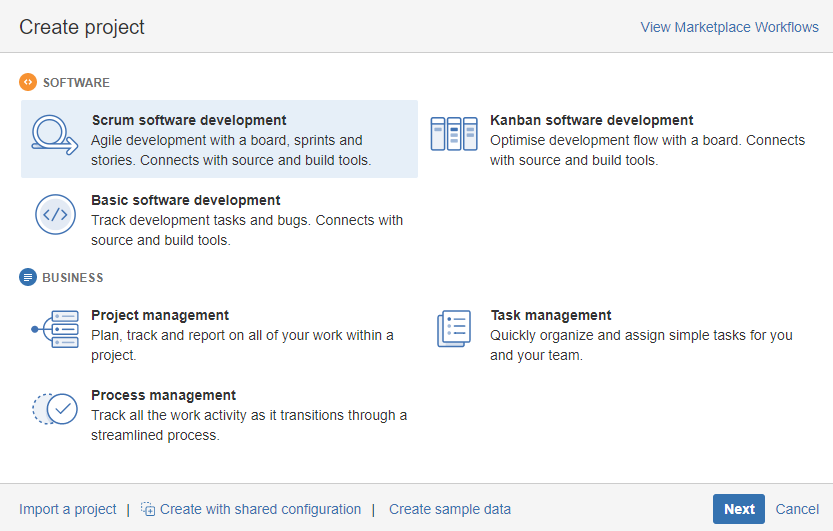

I installed JIRA Service Desk 3.6.2 on my self-hosted server that runs JIRA Software 7.4.2.
When I tried to create a project. I can't find the Service Desk Basic project type!!

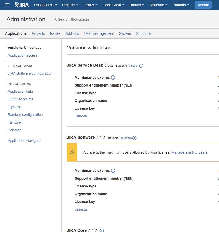

Here is the application page:

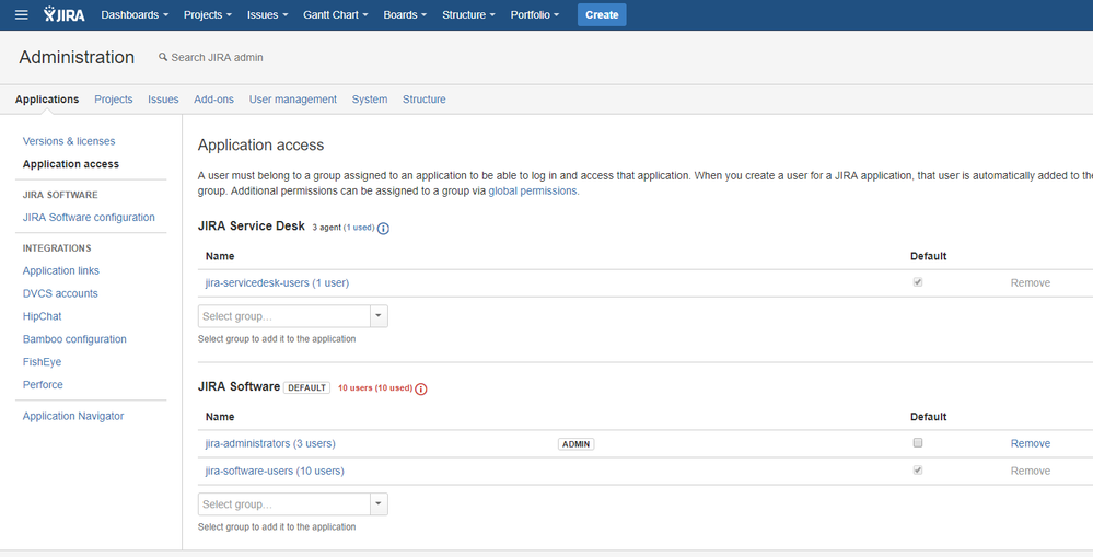

Here is the application access page :
and Also, I have only a one group for "jira-servicedesk-users".
I don't know how to check the missing part?!!

Yes I have the same problem. But I removed it then reinstalled it again with the same issue.

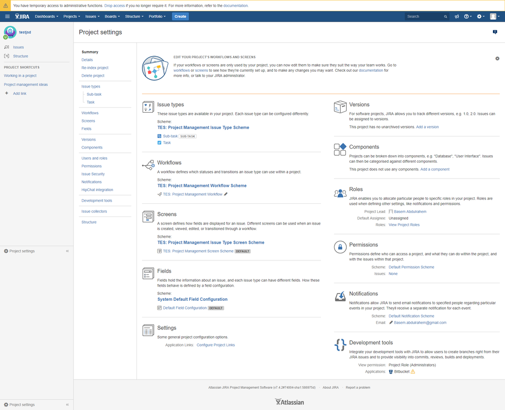

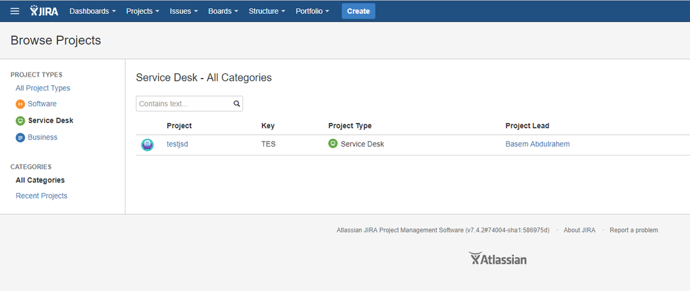

Are you able to take a business project and change it to a Service Desk one?
Yes. I created a Business project then changed its type to Service Desk... But nothing changes in the project view, Just the type became Service desk and it appeared in the service desk projects list.
Ok, so do you get all the service desk config stuff when you go into project adminstration for it?
Can you check who is an Agent in the roles in this project?
This is where I'm stuck.
What you are seeing is entirely consistent with your user not being a service desk agent OR with the SD application simply not being active.
But if you're in the global group (jira-servicedesk-user) and you are named as an agent in the Service Desk project, then you should be seeing all the SD stuff for this project.

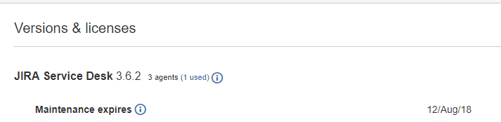

I would want to check the expiration on the maintenance date (your first screenshot chopped it off) and renew if it's gone past (or get an evaluation, just as a test)
If it's not those things, then we'll need to look in the logs for errors, as there is definitely something wrong.
