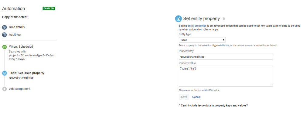

In JIRA Server you need to set the issue property request.channel.type in order to change the channel , you can use Automation for jira as below:
In case you want to see JIRA => {"value":"jira"}
In case you want to see Portal => {"value":"portal"}
In case you want to see Email=> {"value":"email"}
I don`t think JIRA supports other options than theses three above

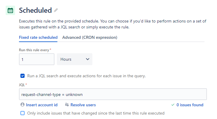

Use the automation rule @Italo Qualisoni created, but instead of the above schedule, use a schedule with a JQL in it:
request-channel-type = unknown
You can also choose to run it every 5 minutes or so (then you don't have to wait that long), but just make sure to stop the rule once they have been set to the correct value.
