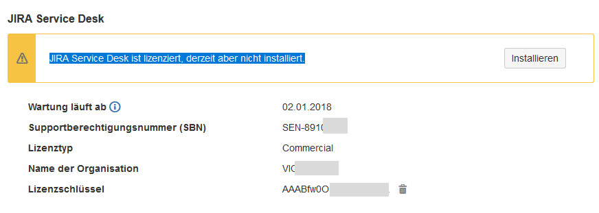

I've upgraded to the newest version of SD last week. Since then I'm experiencing problems because according to Windows -Programs and Features SD is installed on the server but when I login into JIRA i can't access the service desk and it says the tool is licensed but not installed. When I hit the install button next to the message it starts installing but suddenly stops. (see screenshot)Screen.PNG

What version of Jira/Jira Service Desk did you upgrade to and from?  Just by looking at your screenshot, I can see that you have Jira installed, and it looks like you have a Service Desk license, but if you are unable to complete the installation with the use of the "installeren" link, then there is something gone wrong here.
