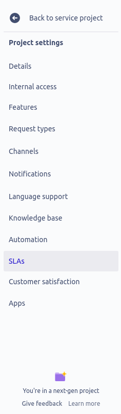

What I mean by "missing issue type option" was there is no Issue Type Menu on the sidebar Project settings on Next-Gen Project.

For Issue Type, I'm still can not find it in my Project Settings. i attached the screenshot.
In a next gen project have a look into "Request types".
URL shows still "issue types" - for this type of projects the logic is combined with the request types.

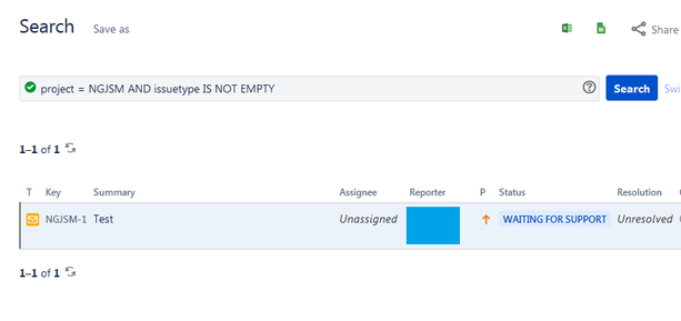

I see then, to create the SLAs, I could use issuetype field in JQL to refer the "request type?
Yes - at least I understood documentation like this.
https://support.atlassian.com/jira-service-management-cloud/docs/write-jql-queries-for-slas/
yes, works using "issuetype" - just tested:
