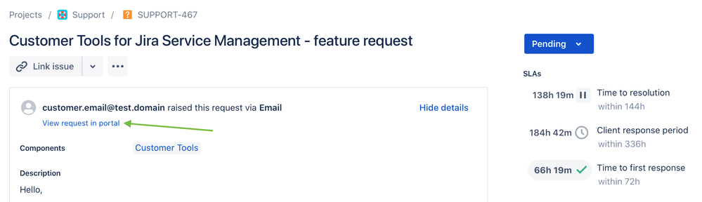

Hi @Alexey ,
The easiest way to obtain url that works for customer is to share following link to the portal (easy accessible by agent in Jira UI, without constructing anything herself):

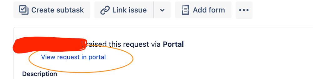

As for dropping the link you would need to construct the link which contains the Portal ID which is tricky to obtain
https://company.atlassian.net/servicedesk/customer/portal/4/NAME-82
I've noticed on the tickets if you right click the view request in portal right under the information of the person who has raised the ticket (this on the JSM admin view side where the ticket is open) then you can share that link for client to view from the portal e.g. below:
