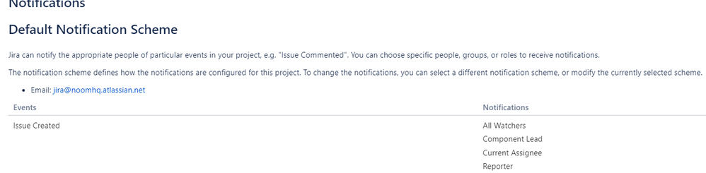

@Paige Annunziato - hi Paige! Two things I'd check:
  • Is the site admin part of a group that has permissions on the project (under People)?
  • In that project's notification scheme, is the site admin explicitly listed (or part of a group) next to "Create issues"?

I took the site admin out of the group that has permissions under the project, but it still shows him. Picture below I am not seeing the site admin listed to issue creation.
Thoughts?

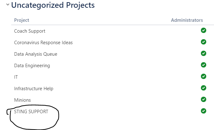

@Paige Annunziato - hi Paige, can you share a screenshot where you're seeing the site admin appear?
Paige Annunziato
February 17, 2021
Yes. The first screen shot shows the projects this person is an admin for (STING support is the service desk project they shouldn't be an admin on). In the 2nd screen shot I try to edit project roles and it appears that the admin box is not checked for STING support.sting support service desk.PNGsting support 2.PNG

@Paige Annunziato - weird! Could be caching?
Double-check using the permissions helper. Can the user do any admin-like features to that project?
Paige Annunziato
February 17, 2021
Yes good question. He did have access on the permission helper, but I think the problem is fixed now. When I looked at the admin list under the service desk people settings I noticed the category site admin was on there, so I removed it.
