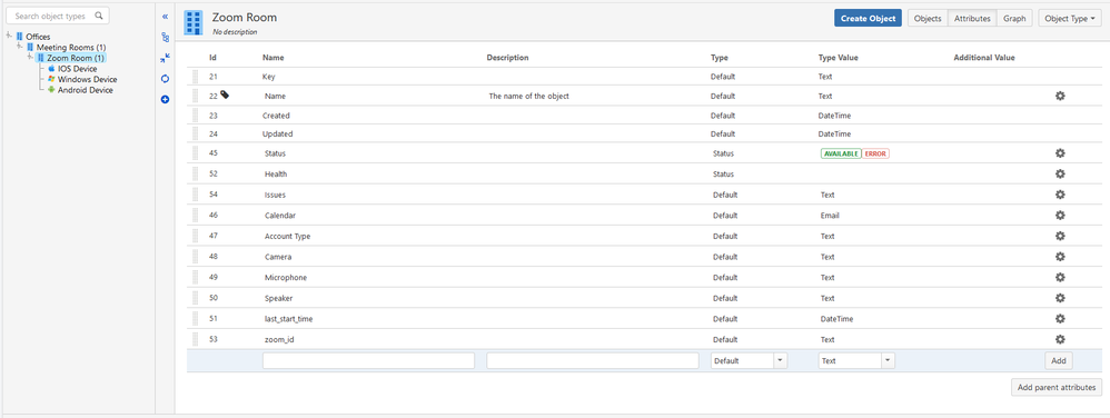

So this is what my object looks like. (Removed the link to parent object for now.
As you can see I am just going to import some zoom rooms and link the assets between the rooms, and the hardware in said room.
