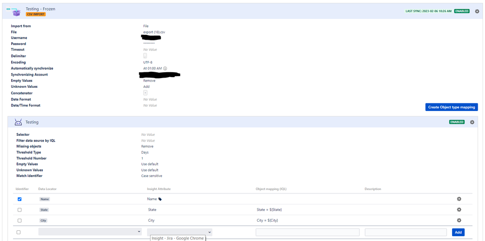

I am importing a CSV and using IQL to do the mapping.
I have references to a different schema.  According to some of the videos I have watched, I should be able reference different things in the schema, and have more than just the label show up.
Here is my test:
Import:
Result:
CSV:

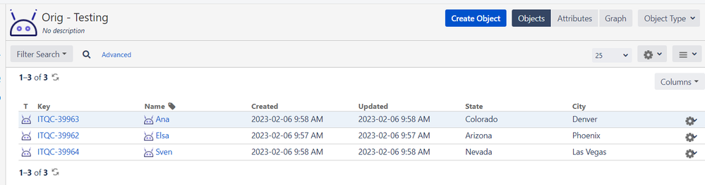

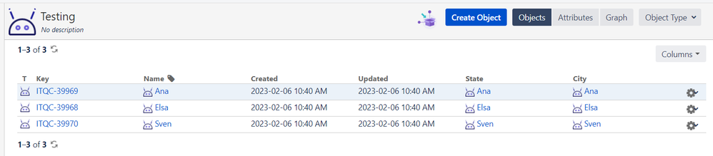

What am I doing wrong?  I am wanting the Result to look the the Original in the State and City output, instead of just showing the label.

Depending on how your State and City Schemas are setup I presume your label in those schemas is also Name, your Object mapping IQL should look like this instead:
Name = ${State}
Name = ${City}

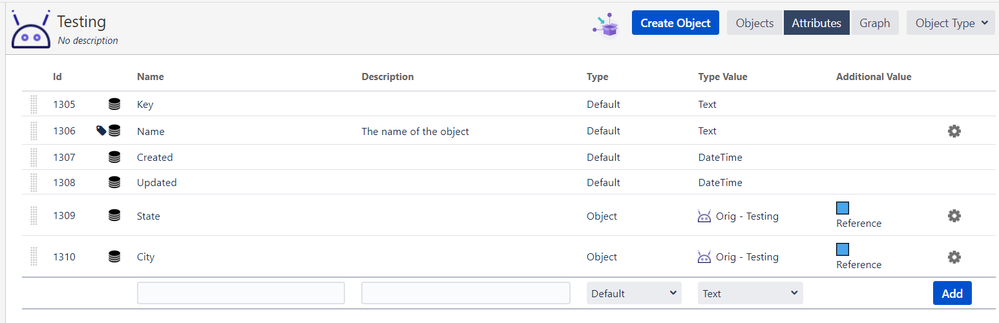

I would also recommend, before you setup your IQL and click Import Data, just go back and check on the attributes that its still set to Object and Schema name as I see in your third screenshot its gone back to Default Text. I had this problem too when I first linked up the CSV.

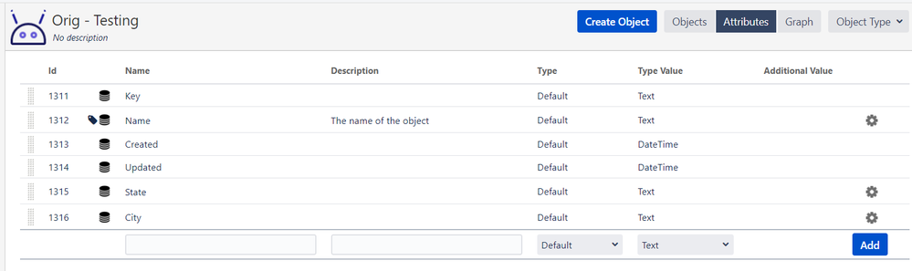

When linking an object, in the main object the linked is shown as the label. On the Testing objecttype you would have to put:
  • Name (is already there)
  • Location => Linked to an Orig - Testing object which then contains a State and City object.
What you ar trying to do actually removes the need for a linked object, since you are trying to duplicate the content of that object to the imported object.
