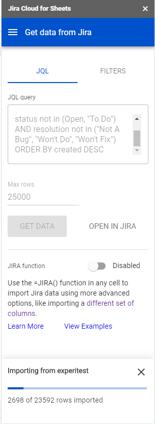

Its still beta but its worked for me (more than 20K issues), used on Jira Cloud
Enjoy https://gsuite.google.com/marketplace/app/jira_cloud_for_sheets/1065669263016

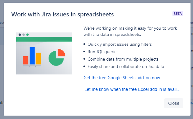

@[deleted] it is a really nice solution to the problem and it downloads ride away a huge amount of data, I tried with 5K in a couple of seconds. I am wondering if there is an equivalent solution for Microsoft Excel, some companies block the use of Gmail and Google accounts at work.
@[deleted] . Excellent solution. It really worked & so fast !!
Thanks a lot !!

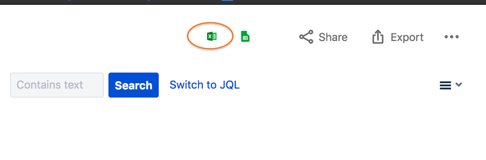

Not sure about server but if you are on Jira Cloud, Atlassian already added export to excel feature.
1. Go to Issue search/filter
2. Click on Excel icon (you can select Excel desktop or online)
3. Configure Jira for Excel app
Looks like it has same features as Google sheets. You can specify how many issues you want to export.
