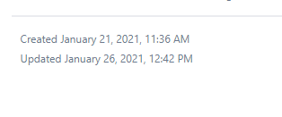

I am trying to be able to see the exact time of an issue created. Now the only thing I see is just the date. I have created some queues on my project but in the columns, I have to option to add "Created".
I tried to create a new custom field with Date Time Picker type. I want it to have as default value the time I can see inside the issues on the bottom right.

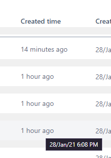

Unfortunately this is not my case. Maybe I described it wrong. My problem is not in the issue view. Mine is on the Queues view as shown in the printscreen below. I need to show the exact time and not just the dateUntitled.png

I created a custom field with date time picket type. Then I went on my project and created an automation with the specific rules. When: Issue Created, Then: Edit issue fields (my custom field, and in the field I entered {{issue.created.withLocale("el-GR")}}
I am in Greece but anyone can choose his locale from here https://www.oracle.com/java/technologies/javase/jdk8-jre8-suported-locales.html
I inserted the custom field on my Queue (the Created time)
The old one and default on Service Management (ex Service Desk) is the created and the difference is obvious!

I wanted an absolute timestamp but couldn't do it. Instead of that I found the way to do my job with this script. I will be 100% sure if it suits me after 24 hours. If it turns to  "1 day ago" it will not and I will have to find another way to fill the field with absolute timestamp

I was able to build the same but it shows me for my "My created time" field a relative value, here "1 minute ago" - so automation works fine.
Additionally, when hovering with the mouse the abolute time (here without locale time formatting options) is display - however, just on mouse over.
Ah wait, from the documentation I seem to have understood the switch is after 7 days...
When the date of the action is > 7 days ago, it will always show the timestamp in absolute format, as per our design guidelines.
... so the requirement "after 1 day" will likely not to be met.
But by substracting a few dates from the automation rule I was able to simulate how it looks when some days are passed - looks then both date and time (a bit cut, but however) is displayed - it looks like this then:
Automation rule contained: {{issue.created.minusBusinessDays(6)}} - just to trick it ;)

Indeed my "Created time" shows now "1 hour ago"
local time is 7:18 PM so after the completion of an hour then it goes to "1 hour ago, 2 hours ago..."
