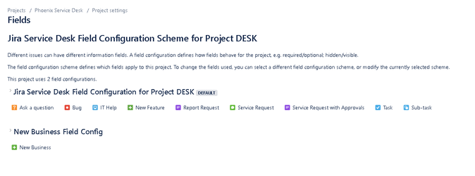

At this point, I am looking at the listing of Issue Types and I was able to update the Field Config to my New Business Field Config, which includes the new fields I want. I have
and below you can see how these all are configured so far:

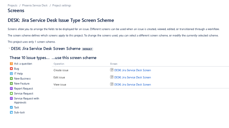

Whenever I go into the Screens though, if I look, it is insisting that I am using only the default screens, even for the New Business type.I have set up a New Business Processing Screen and associated it under the New Business Processing Screen Scheme.

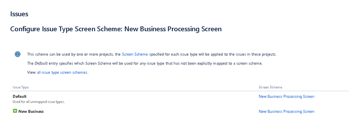

Here I have set up the Issue Type Screen Scheme for New Business Processing Screen
And below, you can see under config, it has the New Business type listed with the New Business Processing Screen.
Why is it not showing this under the project settings for the New Business Issue Type? The field config change worked fine, but the screen will not update, and that is what needs to update so I can see the new fields.

Figured it out. The way I was thinking of things and trying to associate them was incorrect. Instead of changing up the whole scheme from the default. I just needed to update the Issue Types under that one configuration screen under default to also have New Business using the NB screen. I didn't need to create a whole new NB screen configuration unless I really needed to change a bunch of things.
