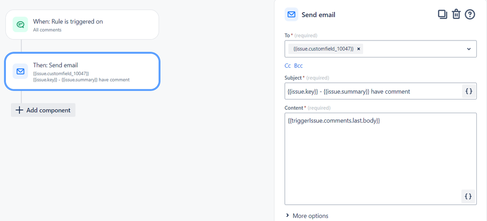

Hi @Andy Heinzer ,
I understand your Point of view regarding the issue collector, but as you know, Admins are bound by the Client's requirements.
But you suggest the right pathway to resolve this problem by creating Automation.
I created one send email automation to send emails to an actual customer who reports that issue from the issue collector.
Here I'm attaching the SS of the automation rule for reference of other community members.
NOTE: I created one custom field Email (customfieldid _10047 ----your might be different).
In the action of the rule, I set the smart value of that Email custom field. and it's working as I desire.
