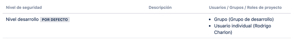

In my company we need that each user associated with a group of users ONLY see the incidents assigned to the group or the user, try to configure this in the security scheme but every time I enter with a user of a specific group I see ALL the incidents, What am I doing wrong?
I have attached configurations, assign security to a group and the user responsible for the group.
Thanks for your attention.

Is grupo de desarollo a specific group or is it a custom field containing a group?
If it is a group and you are a member of that group, you will also be able to see all issues.

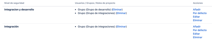

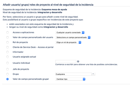

set the first option you told me (1) define two security levels. One level with the integration group only one with integration and development. When the issue is assigned to development, the security level must be set to second level.)
I created two levels issue security for two groups: integraciones and desarrollo.
so, i want that the two groups can to see all type request but only
when the incidents are assigned to the responsible users of each group.
What would I have to put in each request?

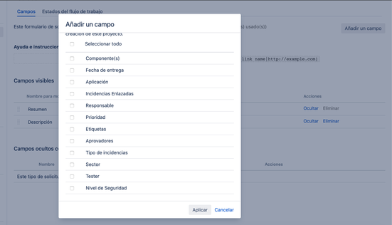

sorry for the delay. You have to add the Security Level field at first to the screen and after that to the request. It will appear in the lower section of the fields. There you can set the Security Level that should be used for this kind of Requests as default.
Thanks for you response,

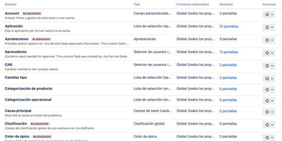

When to said " add the security level field" , Do you mean these fields?
why the field: Security Level field, I can't find it in the data set to add it to the screen and then to the request.
I'm not sure what the security level is in your language, probably something like seguridad. But you must add it to the screen before you can add it to the request type.
Hi!!, In English,
what is his name?
In spanish, i didnt find his name how "seguridad",
:( thank u !
The name is security level in English.
If you can not find it in the request type configuration, go to issues->screens and the select the screen you are using for the issue type. Add the security level there.
Then go to the request type configuration and you can add the field there also.

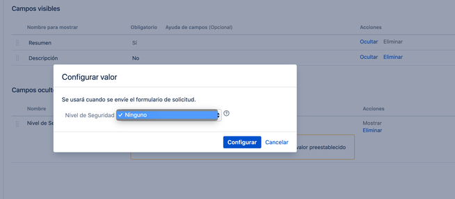

Hello Bastian, Thank you for you response,

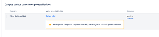

In the project I already have a set the security levels that you told me
Add field security in screen type request, but it doesn't let me set the levels:
what am I doing wrong??

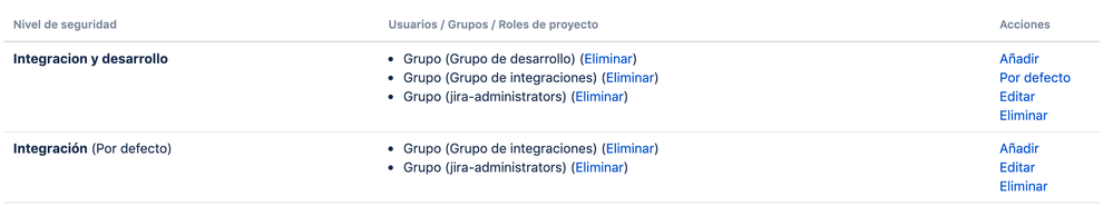

Sorry ,
there it solves it add the administrator group to the 2 types of groups
Integracion is default,
How do I have to set the request types so that depending on the assigned user, a group (integracion) or desarrollo sees it?
Thank U!!
Without other add-ons, you will have to set the right level when the issue is assigned to the user.
If that does not depend on the request type, I would set there the first level, where both groups can see the issue.
When it is assigned to someone from integrations, set the security level to that level although.
If you want to do this automatically, you will need some kind of add-on like script runner or automation.
