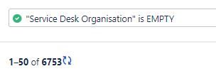

Now, because I want the moon on a stick(!) can you also help with the "Service Desk Organisation" issue I also have?
I have a filter with a few simple bits of JQL:
project = "BLAH" AND created >= 2018-01-01
I have then created a Rich filter and one of the static filters is:
"Service Desk Organisation" is EMPTY
When I run this through the Rich Filter Controller gadget in a dashboard I get no results.
When I run the same JQL separately I do get results - 6,753 of them.

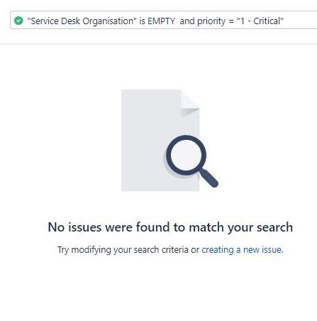

When I add in further JQL to the above query it also returns 0 results. Unfortunately I know there are plenty of Critical issues in our JIRA project!
Once again any help would be greatly appreciated.

Susan Hauth [Jira Queen]
May 2, 2019
Hi Matt,
JQL should be "Organizations" = EMPTY
Try that
