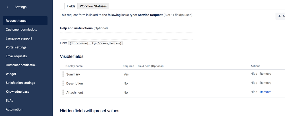

I noticed that when I a set of custom fields as required in the field configuration settings and then create requests for certain issue type in my project the custom field are seen as required even from the customer portal side.
Now if I set the custom field as Optional from the field configuration I noticed that it stays required on the customer portal side.

Can you verify if the fields are made required in the project's Request type field configuration?
In case the field that you are referring to is made required in the configuration then it will appear as a required field on the portal irrespective of the configuration made in field configuration.

thanks. I had to change all the field back to optional in both field configuration and again in the each request type.
