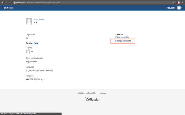

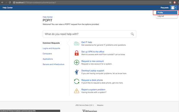

In the Jira webpage, the user would have to login to the customer portal first, from there they have to click on their profile:
That profile page is expected to have a reset password link there:
So this is possible to do. I even went back and tested this on a 7.4.2 Jira to make sure.
However there are other possible considerations as to why you might not see this option in the web browser and why the REST call does not work here.   Chief among these is to determine whether these accounts in Jira exist in the Jira Internal User directory, or perhaps if these accounts exist in Jira because they are connected to a LDAP directory that is setup in Jira to Read only.  In cases like this, Jira can't reset the user's password.  Instead the management of the user account is expected to only be managed in LDAP directly.
To determine this, I'd recommend going into Jira under the Cog Icon -> user management, then searching for this username in question.   That page should be able to tell you the specific name of the Directory that user account exists in.   If this is the Jira internal directory, then I would expect Jira to be able to reset this account's password.  But if the directory listed there is a Connected LDAP, or Crowd instance, then it's possible Jira does not have the ability to change this account's password because it's being managed elsewhere.
