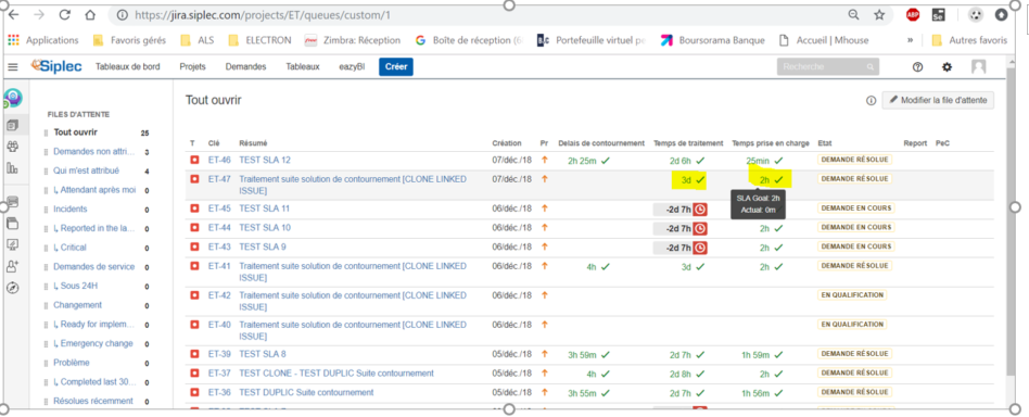

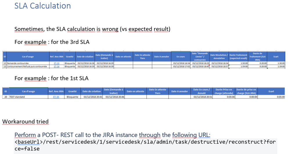

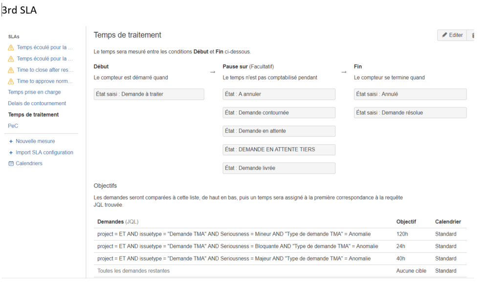

Equipe recette December 14, 2018
Please find sceenshot for the 3 SLA setting and some SLA calculation result
thanks for help

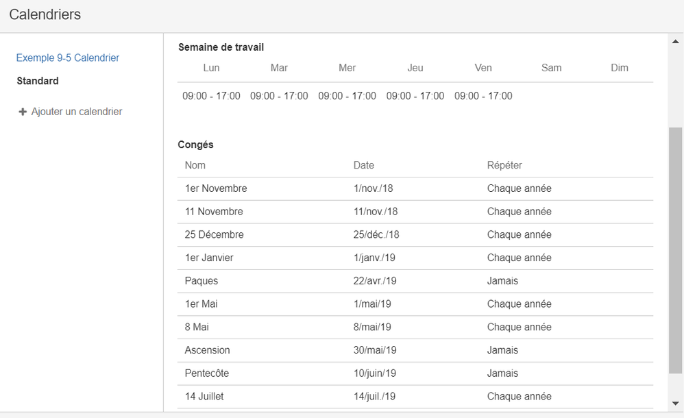

Qu3ntin
December 14, 2018
Regarding the difference I will bet on the calendar. What is the configuration of uour "Standard" calendar.
I think it ends at 17:00, that would match with the difference.
Standard_Calendar-config.PNGThe standard calendar setting is like the defalut setting 09:00AM-07:00PM. The only difference is holiday days added
But actual = 0 is very strange !
Qu3ntin
December 14, 2018
Not if the issue was created AND resolved outside the week work time. JIRA calculates the time within this calendar only.
In your excel, the ticket was created after 7:00PM and solve before 09:00AM of the next working day. So 0 second was spent in the work week calendar.
