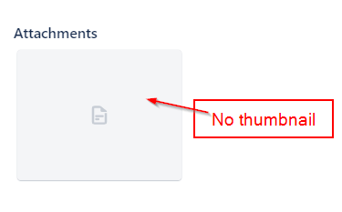

After creating a new JIRA service desk ticket using REST API, trying to add attachment to the ticket. Everything seems to be working fine from code perspective (Able to post the content and getting the response back with image details), though when opening up the ticket in Service desk web portal only a default thumbnail is showing up.
When clicking on the thumbnail following is on the top let corner of screen:

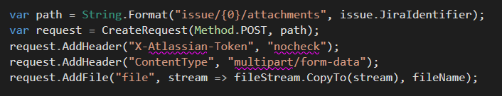

C# Code:
image.pngJiraIdentifier is ticket identifier, filestream is the attachment as stream. This code was working till last week I think. Already tried changing the content type to JSON and event octa stream with no luck.

Your REST call seems to be calling the Add attachment - POST /rest/api/3/issue/{issueIdOrKey}/attachments endpoint.  But since we know you're using Jira Service Desk, I would not have the expectation that a user in the customer portal will have access to that attachment in all cases.  This happens because users in the customer portal don't have access to the issue itself, but rather only the request.  So not all attachments on a Jira issue are expected to be visible to users in the customer role that can only see the customer portal.   If an Agent shares that attachment/image with an customer in a response, then they can see it, but out of the box customers don't see all attachments on a Service Desk request.
Which is why you might have to do something a little different in the case of Service Desk projects. Instead, try using the endpoint Attach temporary file - POST /rest/servicedeskapi/servicedesk/{serviceDeskId}/attachTemporaryFile.   Once this is a temporary file in Service Desk, you can then call the other endpoint Create attachment - POST /rest/servicedeskapi/request/{issueIdOrKey}/attachment.  This should at least make sure that the attachment is added in the manner that a user in the customer portal would be able to do so.
