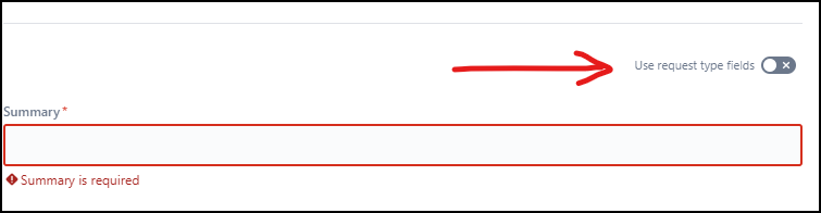

so as I just discovered, opening the create screen in the UI and toggling the "Use request type fields" on/off and then closing the screen again without creating an issue actually dictates which fields are required for rest api calls to endpoint "rest/api/2/issue".
I couldn't find anything about that in the documentation and I couldn't find a way to actually add a json key and value to the REST calls to make sure the backend fields are used, and not the customer portal fields (which have different required fields in out setup) .
I had to actually flip this switch in the UI, which I discovered on a wild hunch as I was desperately trying to figure out why I get blocked by customer portal field requirements.
