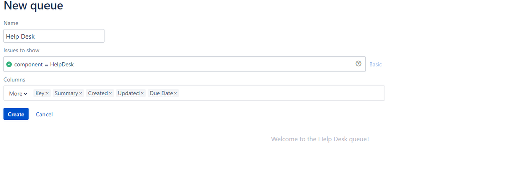

There are multiple ways to do this. You could set up components for Help Desk, 1st line support, and 2nd line support. You can then set up queues that are labeled the same as the 3 new components and then enter a query that will only look for issues with the specific component.

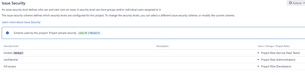

In regards to the visibility, you could create 3 project roles for the 3 levels you want. You can then create an issue security scheme with three levels of security. You will then assign those 3 projects roles individually to each Security level it requires.
You can test around and play with a couple of different configurations, but this is came to mind and I've seen multiple people do. Although, the visibility is not as common as most like for different teams to view different queues.
