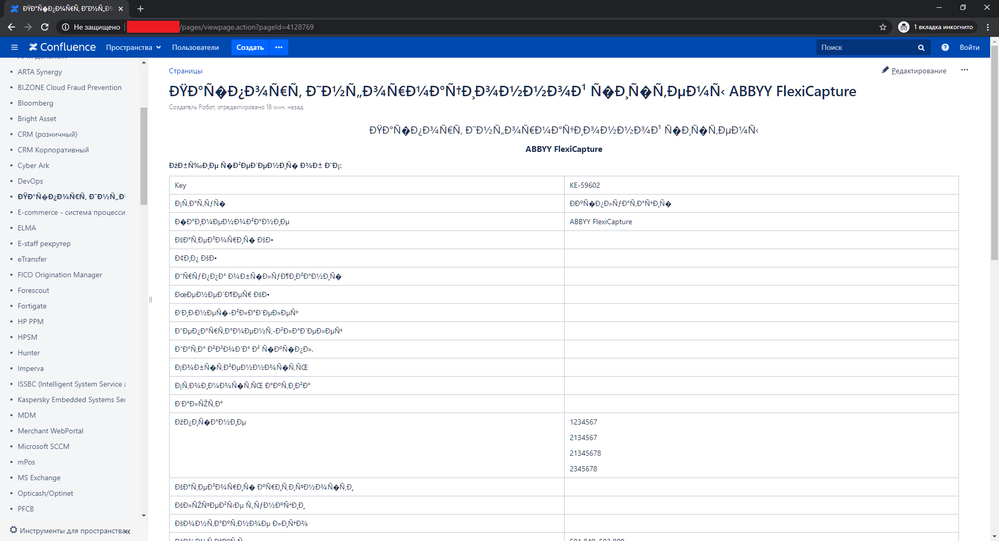

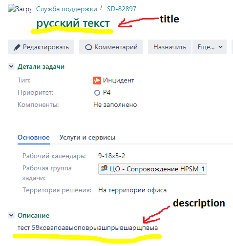

Hi! I have a problem with Jira character encoding. I have a Groovy code which is used to execute POST request to my server app (Express.js) and recieved data has question mark symbols instead of cyrrillic characters.
This is what characters look like from Jira:

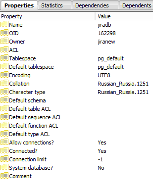

Database character encoding is UTF8 and chartype is Russian_Russia.1251

But on the same Jira server I'm using Insight Automation tool to post data to Confluence server and those characters also are corrupted
Jira and Confluence databases use same config (as described above)
