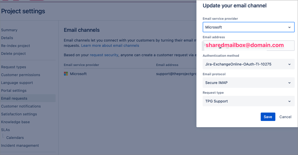

Florian Obradovic February 1, 2023
I have the same issue on JSD 5.4.0 and Exchange Online
  • sharedemailbox@domain.com
  • user-with-full-access-on-mailbox@domain.com is used to authorize OAuth2.0 flow

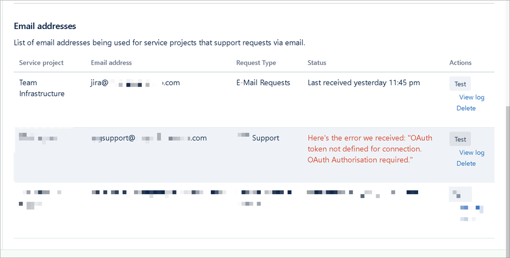

We couldn't connect to your mail server
/secure/admin/SDMailInfo.jspa - Status:
Here's the error we received: "OAuth token not defined for connection. OAuth Authorisation required."
Application Link:
We have multiple serviceDesks which have their own dedicated SharedMailbox. Using BasicAuthentication works fine by allowing IMAP+Basic Auth via ConditionalAccess and setting a password for the username of the shared Mailbox.

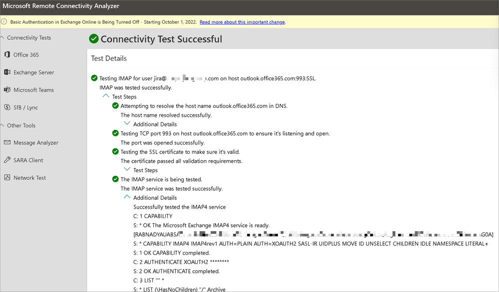

The Microsoft Remote Connectivity Analyzer works for the user I just converted from the SharedMailbox: https://testconnectivity.microsoft.com/tests/O365Imap/input
It doesn't work with delegate access and doesn't matter if it's a SharedMailbox or a regular user.
Message: The IMAP server responded with an error status "3 BAD User is authenticated but not connected.".

After digging around I found out that you have to do the following steps to make it work again with Shared Mailboxes.
  1. Convert Shared Mailbox to Regular Mailbox:
  2. Assign an Exchange license to the user of the mailbox
  3. Connect to Exchange Online using PowerShell and make sure IMAP is still enabled
  4. Connect-ExchangeOnline
    Get-CASMailbox -Filter {ImapEnabled -eq "true" -or PopEnabled -eq "true" } | Select-Object @{n = "Identity"; e = {$_.primarysmtpaddress}}|ft
    # It should list your mailbox
  5. Check with Microsoft Remote Connectivity Analyzer:
  6. Check again in Jira and "Reauthorize"
  7. It should work now.
