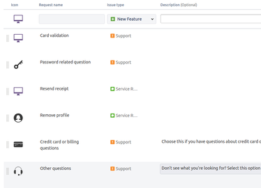

Yep so it isn't possible and the reason is due to the relationship Request Type has to Issue Type. That is the available Request Types are dependent upon the Issue Type. It would be good if you could do this on the Create screen but...
NOTE: "Customer Request Type" = "Request Type" don't ask me why.
Anders,
Include the request type to groups. See attached image.
Victor
