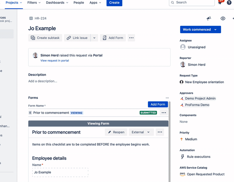

You have hit upon one of the limitations of JSD, namely the inability to edit the contents of requests after they are created. I'm the product manager of ProForma, so I thought it might be useful to run you through the sequence of changing a request type in JSD with ProForma. It would be great to hear of any other solutions to this problem, as we see it quite a bit. It's also worth noting that there is ProForma Lite, which has almost the same features as ProForma but is free.
The process in ProForma would be as follows:
  • The request is initially created using the wrong request type and wrong form.
  • The agent changes the request type.
  • The agent sets the initial form to 'INTERNAL' so that it is no longer visible to the requestor.
  • The agent adds the correct form for the new request type and sets it to EXTERNAL, so it is accessible to the requestor.
  • The agent leaves a comment, notifying the requestor of need to complete and submit the correct for.
One of the benefits of ProForma is that any of the information stored in Jira fields will be carried over from one form to another, which will likely save the requestor quite some time when resubmitting the form.
Below is a quick example of changing a request from a New Staff Orientation request to New Hire Onboarding request. This was done in cloud, but the functionality is the same in server/data-center.
Simon

Hello Simon - I have a few follow-up questions for you. We installed ProForma Lite and I've been testing it out today. I found it overall very intuitive and easy to use.  I created 3 ProForma Forms and associated them with the 3 related requests types in the Customer Portal so the Customer can see and create (or modify) Service Requests by using the ProForma forms for the Service Request. I also was able to do as you demonstrated in the video by pulling up as an Agent an original Service Request created by a Customer and was able to change the request type to the correct (intended) Service Request type, then set the original (incorrect) Proforma form associated with the original request type to "Internal" and then select the correct ProForma form for the modified Service Request type, entered the correct information and then set the form to be be External - and then verified when the customer pulls up the Service Request through the Portal, they see the modified ticket and correct fields and all the updated (correct) ticket information. I also was able to configure the 3 ProForma Forms under "Issue forms" so the Service Desk Agent can very easily create Service Requests directly from any of these 3 Proforma forms I created by selecting them from a list or putting in a search string to pull up the correct ProForma form they are looking for to create the Service Request.
So my first question is this: Assuming we purchased the full version of ProForma,  if we have a Generic "Get IT Help" published in the Customer Portal  and we allow customers to send emails that will automatically create Jira Service Desk Request types, do you recommend that we have a ProForma form created for each conceivable Service Request type we have that are represented by unique fields associated with that particular Service Request that should be used, so no matter what a customer creates under "Get IT Help" or via an auto-generated Service Request created by a customer sending an email, the Agent can either attach the correct Proforma form to the original request so either the customer can add information or correct previous information that was submitted, or an Agent can change the original Service Request type to the correct Service Request selection (if the customer selected the wrong Service Request in the Customer Portal, or they used the Generic "Get IT Help" or they sent an email to create a Generic Service Request ticket) and then attach and make external the correct Proforma Form associated with the corrected Service Request type and then make internal the original Proforma Form they originally used?
My second question is:  Can / should all Service Requests when they are designed in Jira Service Desk just use the Proforma defined form in its place, so that's all the customer will ever see (the Proforma form) and the Agent won't have to attach the Proform form if the customer simply missed some detail when they chose the correct Service Request in the Customer Portal but just overlooked entering some information or typed some information in incorrectly?  In other words, they would be able to correct the form by default since the original form they were filling out in the Service Request was the Proforma form and not a form created via the normal process in Jira Service Desk?
