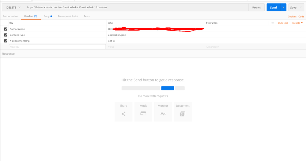

- Delete customer request header

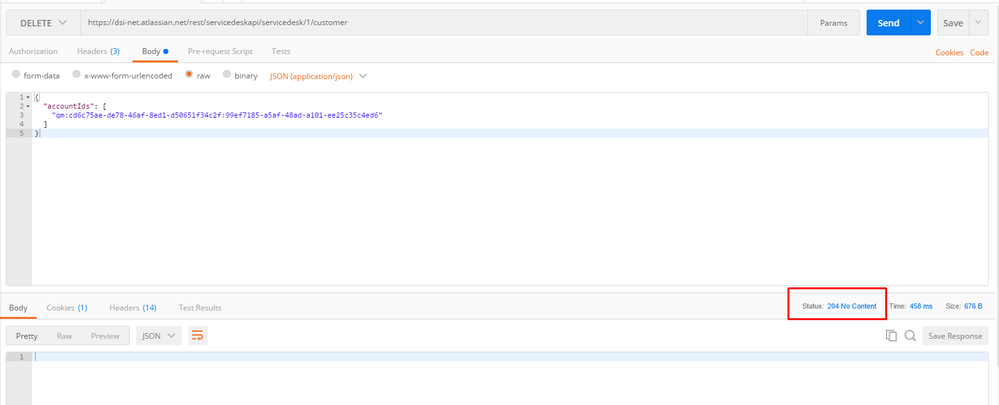

- Delete customer request body
- Request Result

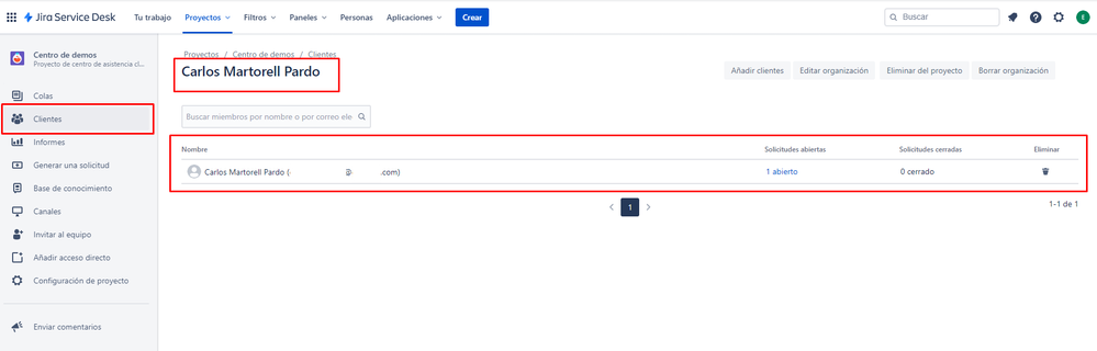

- Customer still appears on the serviceDesk

Hello @Eduardo and @Levan Gogoladze ,
Thank you for all the details and I have been digging into this a bit and I too ran into the same issue with the endpoint as you and it randomly stopped accepting the delete call and simply returned a 204 and keep the user that was supposed to be removed.
We are still working on tracking down the exact cause, noting the endpoint is still Experimental so it does have a few issues to work out and is in constant development and a recent update to the structure may have caused this hiccup, but again we are still tracking down the root cause and we do not have a definitive answer at this point.
Initially the endpoint was working fine with the formatting I noted above, but after your reply I tested again and it had stoped working for me using the same syntax as the previous tests.
Ultimately, it looks like something is getting hung up in the way the endpoint is passing the user accountIds in caching on the backend and we were able to get it knocked loose and working again by adding a new internal test user account as a Global admin as well as a Project Admin to the service desk project, then have that new user run the same call with the noted syntax above, and it worked for the new user, once we then removed the new test user from the Service desk project admin permission it started working for the original admin account again with no change to the syntax, and has not failed again since this process was applied.
Can you run a test with a new temporary admin account to see if you get the same results and let me know what you find to see if this workaround will act as a stop gap for you while we track down the issue causing the block to occur?
