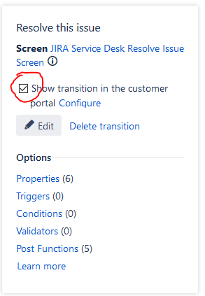

We are having some permission issue with Jira that is not allowing a reporter of the raised issue to resolve their ticket from the customer portal. Our workflow (Service Request) has the correct workflow and we have Show transition in the customer portal enabled for resolve this issue transition.

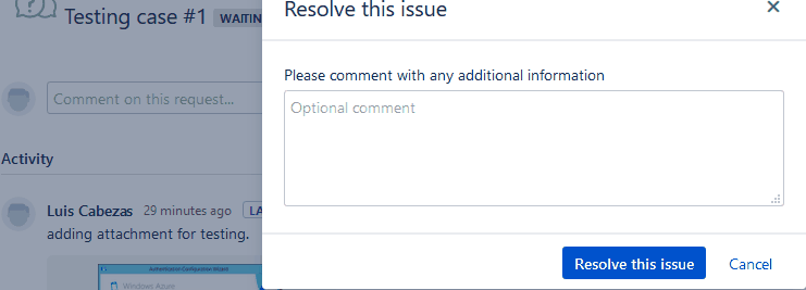

I know you've said "pressing this button doesn't do anything", but I would like to confirm exactly what the "nothing" is. So is it:
Also, does the behaviour change if you put any text in the comment box?

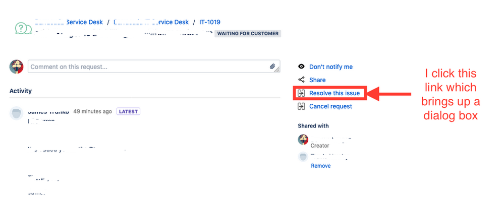

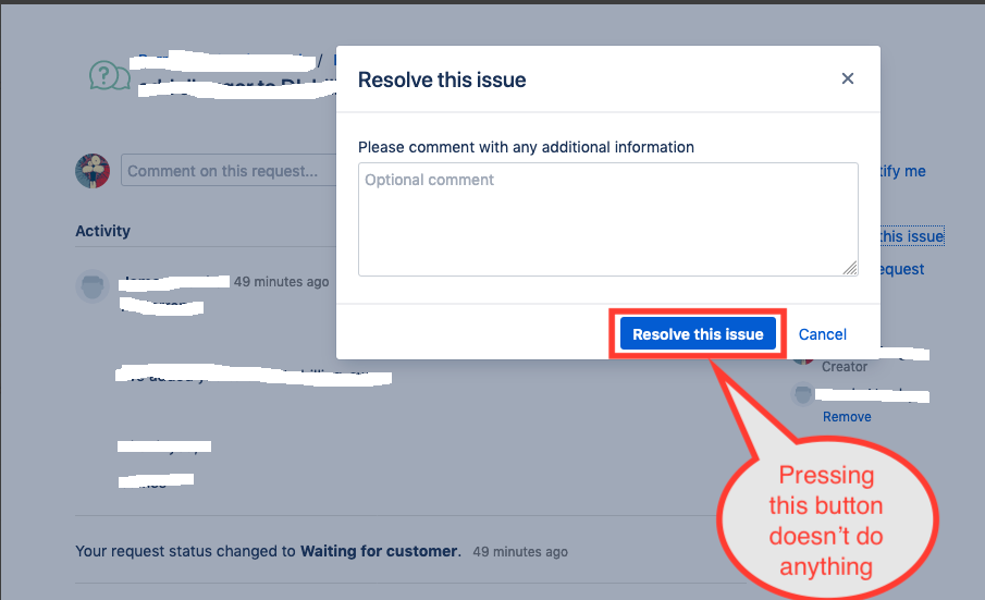

I have attached a gif showing what is happening. A customer tried to resolve their own issue, but when clicking on Resolve this issue does nothing at all as you can see (hopefully). Even adding a comment does nothing.
This is enabled in our workflow, and from reading the documentation should give users the ability to resolve it.
I have exactly the same issue when trying to make the customer able to Cancel the issue.
I have a "Cancel" transition to a "Canceled" (Resolved) state, Visible on Customer Portal, and I get exactly the same behaviour described above.
Inspecting the customer request I found that while trying to run the transition AJAX request:
"{"errors":[{"errorMessage":"We couldn't make that happen because you don't have Schedule Issues permission.","field":"customfield_10007"}],"reasonKey":"transition failed validation","reasonCode":"400"}

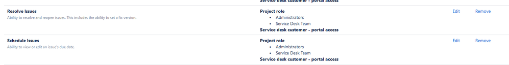

Adding the "Schedule Issues permission" to Service Desk Customers - Portal Access, made it work ;)
Weird nevertheless...
I checked and I already have that permission set when this happens =( and it will did not work. Ugh. Thank you for the tip though.
