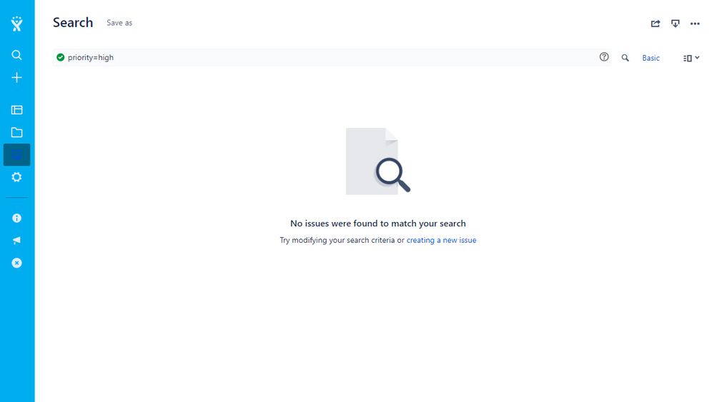

Thanks for your help so far - I will close but on point 2, can you elaborate a bit?  Where do I go to edit JQL?  A screenshot would be the icing on the cake.
Susan Ostreicher
August 31, 2017
Dave, there might be a more elegant way to get to it, but I usually start by running a search.  One you're on the search results page, you can modify your query to use JQL.  The type-ahead feature helps you figure out what fields are available, and there's also some documentation here on advanced searching.  Screenshot (31).png

Sorry @Dave Gunn. I wasn't aware you had not used the JQL capability as yet. :-) This is one of the fundamental, and very useful capabilities. You can start w/ the Basic view (selecting values) and quickly move to Advanced where you write you JQL out manually. I rarely use Basic anymore. When you use Basic you can then click Advanced and see the litteral translation and can then edit.
Click on the "Issues" menu and select Search for issues...
Basic Screen:
Advanced Screen:
I highly recommend some articles written by @Maarten Cautreels (Belgium) which can be found by searching in the Community for "JQL ninja". And of course as @Susan Ostreicher pointed out use the Atlassian docs.

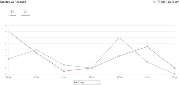

1) you should have a Created vs. Resolved chart in the Reports section. that looks like this...

August 30, 2017
@Dave Gunn, for sure you can use JSD Reports to view "last 7 days". I need more info to be able to provide a good answer.
  • when you say "ticket activity for the week" what specific info do you wish to see? Open and Closed or also updated.
  • what do you want the report to look like? Filtered list? Chart?
  • is this to be an emailed report or something the audience would access and look at as desired?
  • who is the audience? Are the Agents, admins, customers or may you have JSW and want those users to have access?
